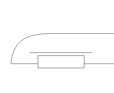

All I can think of is similar to what you have already suggested.
make a slit in the wing just an inch longer either side than the aileron itself and put the rod there, rather than the whole wing. You'll want to retain the Dihedral, so having 2 seperate rods near each aileron will keep the wing directly ahead of the aileron straight, while the rest of the wing is allowed to flex as normal.
like so:
I had this problem with my scratchbuilts, I deliberately put dihedral into the wing and held it there with spars supported on the fuselage, but the perma-bent wing meant that my packing tape hinged ailerons were next to useless and would pop up or down when the servo was at full extent either side. not ideal for steady slow gradual movements.

I have to use 2 rods the wings come in 2 halves, I was thinking of the length of the rod being just over the length of the ailerons, but their pretty long.
I was more interested in if anyone else with a Ease Star had experienced this problem.

Hi all,
The problem was that the wing was bending the hinge on the aileron, stopping it from working properly.
I have included a 8mm carbon tube running parallel to the aileron, I then covered with woven tape, gave it a test flight, and was amazed with the difference, its now rely responsive and a joy to fly. I'm waiting for some Clover antennas, and a nice day to jump on a train and get her out of London for a advencher
thanks to you all for your advice.
