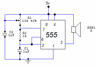

I'd thought about using a tone generator where the speaker element is wired directly to the audio on on the VTx to provide a constant tone for audio input, rather than relying on the random rush of wind.
Would that address the whole sound issue do you think?
Thanks for the thread Ian, it's given me a good heads up on what to do when my SkyWalker arrives :D
Hi Rich, why would you want to send a solid audio tone down a channel ?
